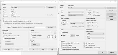

Hello to everyone.
When exporting from Revit to AutoCAD I also get a pcp file.
I use "Add-A-Plot Style Table Wizard" to convert it to ctb file, but it doesn't convert really accurately.
First, the colors, they don't convert at all. As you can see in my little example, from Revit everything except the logo prints black. From AutoCAD everything prints in color.
OK, I can solve this manually, but is there some better way? It's not an issue with drawing that are mostly black, but could get tedious with drawings that use a lot of colors and shading, to hunt down all those colors of layers.
Second, the thickness. I deliberately set ridiculously thick lines for walls in Revit to illustrate the issue. Thickness don't translate in AutoCAD. At all.
It's clearly visible in this example, but it's worse when you don't use ridiculous values, then everything just ends up being the same thickness.
Any way to solve these issues?
Here are prints, first Revit, second AutoCAD.

Forgot to mention, when line thickness is turned on in AutoCAD itself, those thickness do seem to translate correctly.
If that can somehow help to solve it.

Prvoime
@RobDraw
Revit is "What you see if what you get" type of software. How something looks is determined by its category.
So if you want your wall lines black, 0.7mm thick, that's what you get, on screen and printed.
When exporting to dwg it automatically creates a PCP file, and objects in Revit are translated into layers based on standard you choose (AIA, ISO, some other...).
