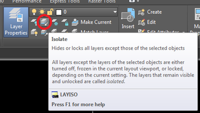

MSewell
How about layer states (command LAS)
RobDraw
The isolate layer command has an option to lock and fade the other layers. Check your settings.
Rob
Kent1Cooper
The command name is LAYISO:
Call it up and use the Settings option to choose how you want un-selected Layers to be handled.
