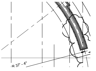

I am trying to get a wall cap to loft on both a radius on the plan view and elevation.
I have attempted to use guides but it has failed. any help getting this done would be greatly appreciated.

Create a horizontal lofted curved solid and a vertical lofted curved solid. Use the Intersect command on the solids to get the resulting solid incorporating both curves.

joeQW4TM
@imadHabash
here is a snippet of what i am trying to accomplish in elevation.
the foot print of the wall is a half circle.
