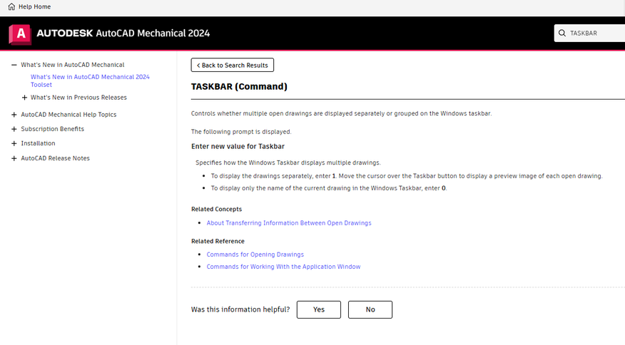

May I ask, why can you not still use the taskbar? Did you actually set TASKBAR command to something you want yet

I tried the TASKBAR command, which condenses everything down to one taskbar item.  But what I used to do was have all my apps on one screen's taskbar.  And have all my Autocad drawings on the other screen's taskbar.  And set up the taskbar for 2 rows to have space for all the drawings to display in the taskbar.  Now once you open multiple drawings, it crams them all into the side with all the other computer apps.  And a "feature" of Windows 11 is you can no longer have a multiple row taskbar, or so I've read.
