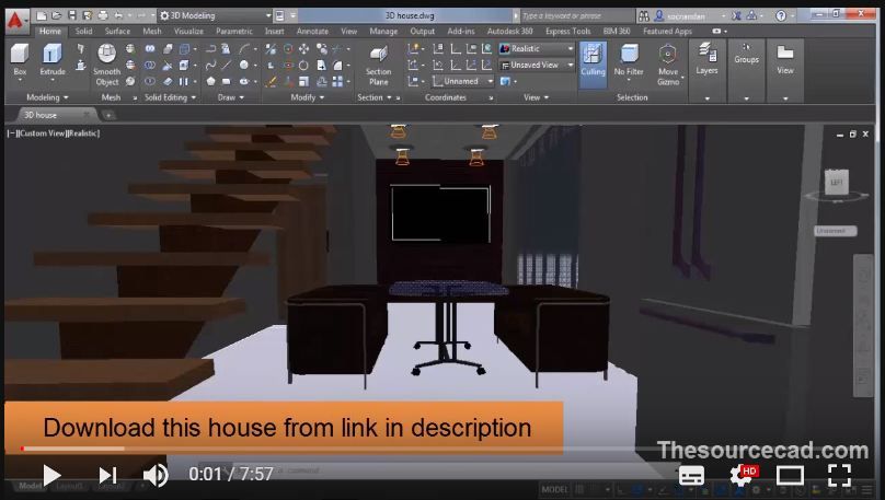

Where is the button that makes 2d to 3d like this??????

john.vellek
HI @Anonymous,
The dwg that we imported into AutoCAD has no 3D information in it. Everything is truly plan (2D).  I am not sure that the Homestyler allows a 3D export.
John Vellek

Ah and what should i do???? I want to render it to 3d and add items and floors!
