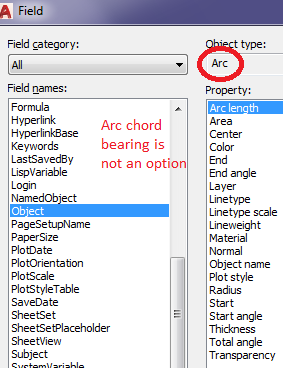

Patchy
FIELD
Kent1Cooper
@Patchy wrote:
FIELD
Not....

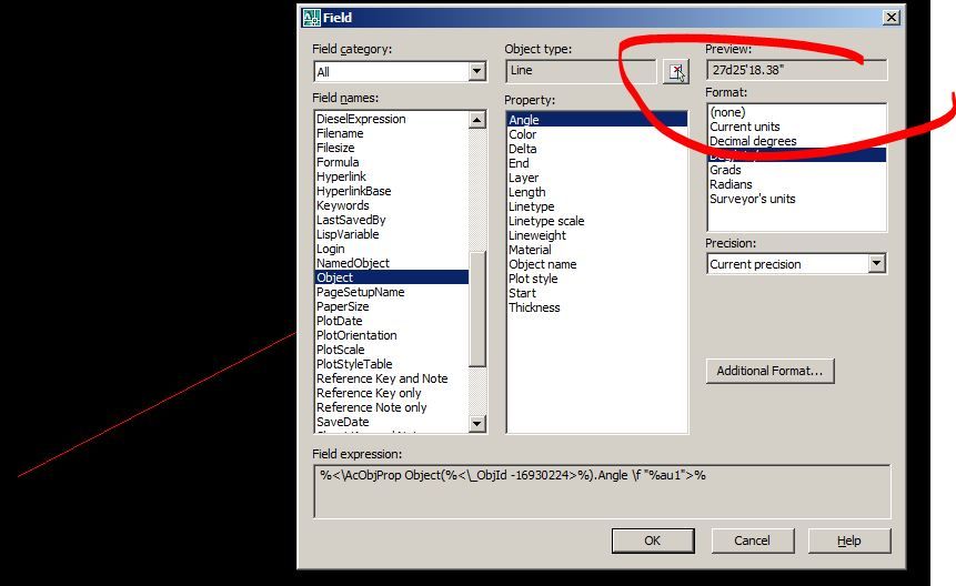

But you could draw a Line across the chord, and look at that, for which you wouldn't need a Field, but just the Properties palette or List command.  Set your angular Units setting to Surveyor's Units if that's the kind of "bearing" display you want.
