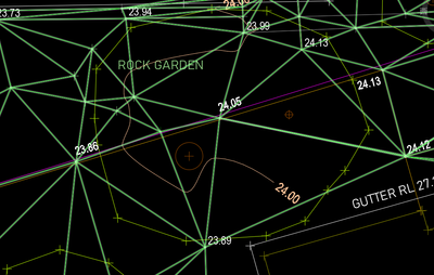

I have surveyor drawings come back to me with a modelled topography in AutoCAD. They do give me some points to show the level of the ground (height above sea).
The numbers in white are the levels done by the surveyor. The green Web is the 3D topography done accurately by the surveyor. The point they plot are EXACTLY the Z coordinates, eg, 24.05m above sea level on site is exactly Z = 24.05
Is there a way for me to plot directly onto the topo surface and get the exact Z coordinate?
I have tried multiple methods, including making/using Z coordinate annotation blocks. They fail me when I use them on other projects.
Is there a .lisp available for these type of situations?
Thanks in advance.

Hello, sorry for the bad English, not my strong language 😞
So in short, I want to find the Z coordinate on any point of the 3D surface. How am I able to plot this point on the surface with annotations suggesting the Z coordinates?
Thank you

@jiahao.billy   I thought I would try to reproduce with VLISP the Civil 3D program feature of being able to pick points on  a TIN and get the spot elevation.
The following program enables you to add points and elevation values at picked locations on a collection of 3DFACEs.   The program prompts you to select a collection of 3DFACEs and then the user can pick any point to add a point on a 3DFACE with text that notes its elevation.
In writing the program I needed a routine to determine if a point was within the bounds of a triangle. I could not find any that I liked so I wrote my own.  At first I thought it necessary to determine if a point was outside, on a triangle vertex, triangle edge, or fully within the bounds of the triangle.  I later determined that the point on an edge distinction was not necessary.  As a result there are unnecessary elements still in the code related to edge detection.  The program could be more made more efficient but some testing indicates that it is very reliable.  One major assumption that could affect results is  that the first three vertices of a 3DFACE are used to determine its geometry. The code could be modified to look at all four 3DFACE vertices to determine which three form a true triangle.
Here's a sample of the output.

jiahao.billy
Thank you!
This worked perfectly!
I would first have to EXPLODE my topo plans before I could detect the faces.
I had a look at the code and I couldn't fully understand the magic behind it. Hopefully I'll learn it in the years to come 🙂
