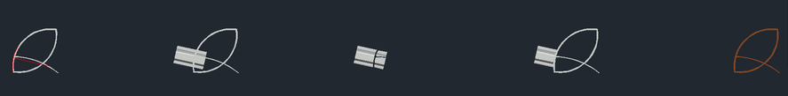

I made an illustrator file, which I exploded, then joined again to make sure was making a closed polyline. I extruded it in the attempts to subtract it from an object. Here is an image of the output.
I can't figure out how to create a face for that text. What I mean by face is making the text itself to be engraved, and not just the path of the letters.
And also I tried extruding the crosshair to the left in the image and I got an error: "Cannot sweep or extrude a self-intersecting curve."
Does anyone know how I can get around that?
Thanks in advance

I've tried exploding, overkill, rejoining. No go.
I've attached the file. I'd like to learn and not just have someone do it for me.
So I have a projection layer you'll see. I used that to project to text onto the curved surface.
I then extrude the projection which, you are correct, is curved. Can I only extrude a flat surface?

Same issue, but I've figured out what is happening.
I started again from step one of extruding the Projection layer, clicking on the extruded text every step to see when it turns into a region.
It turns into a region when I use the SEPARATE command; subtracting the card holder shape from the extruded text.Screen Shot 2018-12-31 at 2.38.34 PM.png

I'm think it's because you're using 2019. I'm on 2018 student version. I will check our school's site if 2019 is available yet or not. I read that all the "toolsets" are included in 2019, so that must be auto-correcting it for you.
Here's a screen capture of what's happening on my end.
I mess up the first go by not selecting everything, excuse that moment lol.

You used EXPLODE!  That is what is turning your solids to regions or surfaces.
You must use the solid editing tool for Separate.  I don't know the Mac menus for where to find it but the long form would be:
SOLEDIT enter
choose Body
choose Separate
select the solids to divide.
Blaine Young

Your previous message was "SOLEDIT" So I kept trying to find the wrong thing lol
I did the SOLIDEDIT command, and it worked Smiley Very Happy
