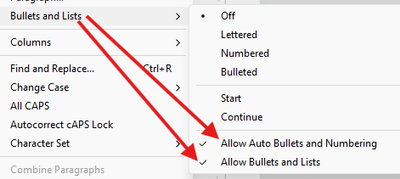

Are you using TABS for spaces?
Do you have have these two checked inside your MTEXT editor?
