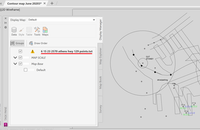

I have trial versions of Auto Cad 2023 and Auto Cad 2023 3D.  I am trying to make a contour map.  For days, I have read numerous how-to articles in the Autodesk community on the web.  But I can't find Prospector or Toolspace.  I am pretty sure I have the points imported, though some aren't showing their descriptions and I exploded the block.
If someone can look at what I have done and tell me the steps to finish this project I would greatly appreciate your effort.

Pointdump
Hi Sharon,
Where is "6 15 23 2570 athens hwy 129 points.txt"? Can you post that file?
Your drawing is assigned GAHP-WF coordinate system, but the linework is helengone to the west of the extents of that coordinate system.

ChicagoLooper
Hi @Pointdump
EPSG 2239
You can try downloading elevation data HERE.
Then do like this:
Then Unzip File=>MapImport=>Create Object Data=>'Raise' contours based on OD Elev <<OK to raise manually w/o query>>
Next, Toolspace=>Create EG=>Definition=>Select the imported Contours=>Add Boundary.
Optional:
Surface=>Contextual Ribbon=>Surface Tools=>Extract from Surface=>Extract Objects=>Major & Minor contours

Thanks I have downloaded the shape file in AutoCad Map 3D, but I still can't get Toolspace - when I type the command I get the same error, not found.
