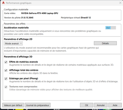

let's fix it all then: start by sharing a screenshot of your AutoCAD's _ABOUT command pop-up as well as a screenshot of your AutoCAD's GRAPHICSCONFIG command pop-up too please.

mobilal
Here are the screenshots that you requested
And I'm running on windows 11 latest updates.
Thank you

You don’t have the 2022.1.3 Update: get it from your Autodesk Account Page here https://manage.autodesk.com/cep/#products-services/updates
Restart your PC afterwards.
Then set GFXDX12 variable to 0 (that's a zero) then restart AutoCAD/LT.
