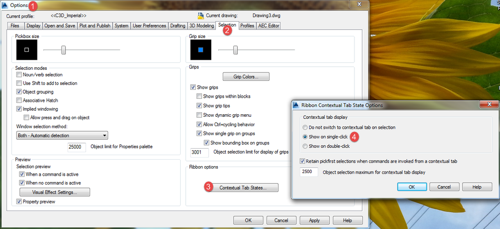

I just upgraded to 2017 last week - I know fun, fun.  I have some hatching in a drawing I had that I am trying to change some properties such as transparency, pattern etc.  I do not get the hatch creation menu that I used to get (in ribbon) when I edited a hatch pattern.  I only get the menus when I create a hatch.  what's up?

Check this setting in OPTIONS.

Where would that be found in the options? The only hatch selections in options is associative hatch and ignore hatch in snap.

Do you not see the inline image? It's clearly marked on there.

Click on image below to enlarge

I do not have the 3 options to select so I guess "no I didn't see" is the obvious answer.  all I have in my selections is Retain pickfirst.... and object selection max...

My bad @Anonymous. I was using 2014 to make that screenshot. You're right, 2017 is different because they changed the way it works.
Is it possible that the menu file has been modified and that the contextual tab was removed?

I am running 2017.1 and I don't see those choices either.
Maybe you need to change the CUI setting.  See image.

The contextual tab is there, the 3 selections are not there - where you noted to select show on single click. All that shows are the retain .... Selection and object selection max...

I know the 3 selections are not there. Maybe you missed my earlier reply when I said I took that screenshot from 2014 (not 2017).
Take a look at this document on how to PREVENT contextual tabs from appearing. Maybe something on this list has been DONE on your system. (I know it says 2015, but this is when the behavior changed - it's the same in 2017).

I have looked at the contextual tab in the cui and the hatch creation is set to full with focus - this brings the ribbon up at hatch creation but not at selecting a hatch to edit.  If I set it to full w/o focus the hatch ribbon does not come up at all, even when creating a new hatch.  I have hatch selected in the contextual tab area but no selection to expand or add to it (not sure if it should have).

You will need to find the tab from the Ribbon - Tab section and drag it to the Hatch Selected Contextual tab area.

Excellent GiantsPirate!!!  That worked.   I have read that paragraph a couple of times but it did not click in my brain for some reason.
