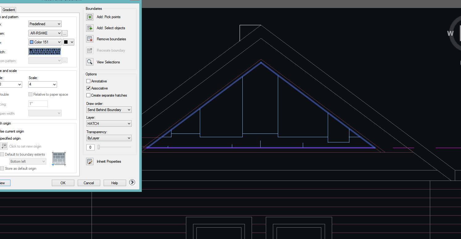

Hi There,
I have been trying to hatch a portion of a wall with the concrete hatch. It is not annotative hatch, my drawing is not in an annotative scale at all. I can see one of my hatches that I did during another work session and it is at the correct scale. But, even when I try to copy this good hatch and stretch it accordingly to suit the new wall shape, it disappears.
I saw other posts about the annotative scale, but my hatch is not annotative, so I don't think this is the issue.
Please help!

thehivedesignco
Hi Blaine,
I checked the fillmode and it is set to '1'.
I cannot see the hatch border for my non-visible hatch. What is happening that with my hatch scale set to 1, I cannot see the hatch. When I set the hatch scale to 2, or 3, or 5 for example I can see the hatch but it is too large for what I want. Once I make it 1 or smaller scale it goes invisible. I have attached two screenshots. One with the hatch scale set at 1, and one with the hatch scale set at 4.

Message 10 of 10
thehivedesignco
Hi @Alfred.NESWADBA  and all,
The solution was the HPMAXLINES scale. It was set to 100, so I changed it to 100000 and that worked!
