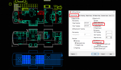

type DSETTINGS and from Snap and Grid tab do as below image .

Hi, I followed your image and this triggers the dots to show up. If I do not toggle the dot paremeter the grid does not show up ???

Explore checking and unchecking this box (see image below)to get the effect you desire, otherwise this might be a good time to start posting screenshots from your desktop showing what you want/do not want.
