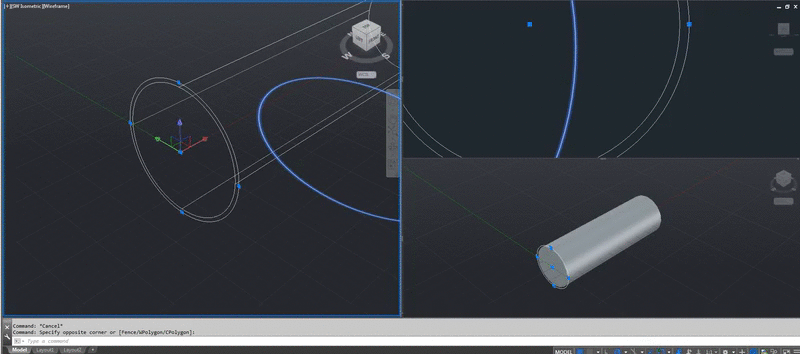

I don't really know how to explain this, so watch:
As you see it makes the outline circle in a random place, then blue stuff is everywhere. Gets annoying after a little while. Is there a way to fix this. I just got the program today so if there is a fix and this is a obvious question, please don't beat me up with hate. I really love the program so far, just not this.
My graphics card is a Nvidia Geforce GTX 750 Ti (Modified my EVGA), and drivers are up to date.

Even with the animation, it's a bit difficult to know what's going on.  You might try changing SELECTIONEFFECT = 0 at the Command line and/or disabling Hardware Acceleration temporarily while troubleshooting (GRAPHICSCONFIG)
When you disable hardware acceleration, does this circle appear too?
When you open the graphicsconfig dialog what driver do you get shown as used (best would be to upload a screenshot from that dialog).

I set SELECTIONEFFECT to 0, and everything is fine now.
