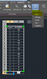

I haven't seen an update so I created an attributed block, ran a data extraction and then exported to Excel to add the SUM. In addition, if you select the last row of the table and insert a row below it, unlock it, then you can add a formula that will create the SUM. No need to even export outside of the drawing file!
