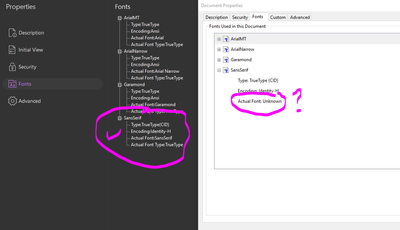

just recently - my dwg to pdf plot configuration quit working
All my pdfs text look like hieroglyphics, and i get an error message that my font can not be found
 can someone help.?
 I even upgraded from 2018 and it still not working
pdf attached for reference of output

Curious how the missing SANSSERIF font alert only shows up in Adobe Acrobat but not in any other PDF viewer I have on my computer, even when I open your PDF in webbrowsers like EDGE and Chrome here.
Can you test that at your end too?

Yup only ADOBE - and not just my adobe  anybody I send it to

What else changed on your PC/system since this started showing up?
Do all of your DWG files do this, or just this one?
When you installed R2020, did you make use of the migrate feature, aka brought the problem along into R2020 from R2018 by chance?
What if you use all the other 5-PDF drivers in R2020?
What if you use a 3rd party PDF driver?
I have no idea why Adobe Acrobat cannot find the font when the other PDF viewers can (see below) other than some old posts that seem to identify a possible character issue in your text

yes the other pdf creators work - just not the dwg to pdf
and I should have thought about the migration..(kick myself ) but yes I brought it along
i may uninstall and reinstall later tonight to see what happens
All my drawings are doing this.. nothing changed - unless one of those automatic updates happened

Resetting R2020 may be all that you need to do, here is how https://knowledge.autodesk.com/support/autocad/learn-explore/caas/sfdcarticles/sfdcarticles/How-to-r...
Then ensure you have the 2020.1.5 update installed https://knowledge.autodesk.com/support/autocad/learn-explore/caas/CloudHelp/cloudhelp/2020/ENU/AutoC...
Also, if DWGTOPDF continues to be a problem, then just use one of the other PDF drivers bundled in AutoCAD: "general documentation" one is good for most users' needs. There is a reason for 5 PDF drivers after all 😉
