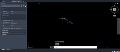

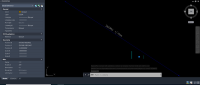

When I exploded the Block reference to sub-elements as dimensions and lines...etc using the "explode" function in AutoCAD. After explode and before explode dimension display is incorrect. Attached are the supported files FYI.
Please help me how to resolve the issue?

The reason is because the block was scaled down by 0.1.
You can redefine the block and then select all blocks and change their scale ratio to 1.

Thanks for the fast Reply but facing display issues. Also, I have more number files and observed a similar issue.
So, redefining the block is a costly operation for us.
After changing the block Reference scale to 1 and performing the explode. Before and after explode dimension display matched.
Could be please correct me if I'm wrong, explode will be used for exploding the entities to individual entities and I thought the display will remain the same before and after explode is it right?

Dimensions can change after explode.

For dimensions it is not correct - if you scaled the block.
