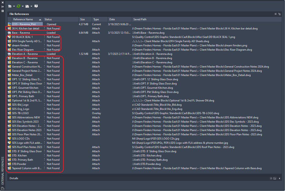

Please see the enclosed files you have to reload the xref's  hope that's ok. The electrical blocks and some text are still referencing the $0$ layers when run a list command. Thank you for your time
Message 16 of 19
adeines
Original sample drawing before I tried to fix the $0$ layers w/ fixbind. We are training our ppl to not edit in place but we have a lot plans to fix
Message 17 of 19
paullimapa
When I open 2235 - Ravenna_Plot.dwg from both Zipped files there are missing a number of xref dwgs
Only the two dwgs you included in the zip are shown as "Loaded":
Base - Ravenna.dwg
Elevation A - Ravenna.dwg
Perhaps you should use the eTransmit command which would automatically collect all the remaining xref dwgs into a single zip for posting here?
As a test what I did was open the 2235 - Ravenna_Plot.dwg & xref Bind the two "Loaded" xrefs and Detach all the "Not Found" xrefs.
The following xrefs I could not Detach:
In addition to FIXBIND I also loaded another routine called FIXBOUND which seems to take care of those $##$ characters at the beginning of the names.
So give FIXBOUND a try.
Note: may have to run FXB more than once to complete renaming process.
