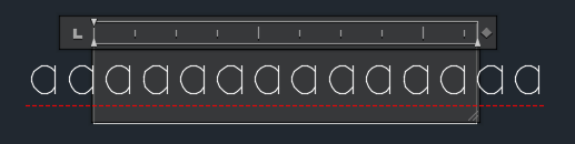

MTEXT does not seem to provide the desired effect.
tex inside box
Adding 5 more "a" characters.
Overlap
The text still wants to overlap its desired bounds and requires manual editing of the width factor to make it fit the box.
Adjusted width factor
The time saving factor of an automatic width factor calculation is to not have to manually adjust the width factor in the event of the overlap of the border.
User gets to define this distance and no matter how many characters get added the width factor automatically adjusts to keep the text within its limits.
Autocalculate distance in Red
Hope this clears up my original post.
