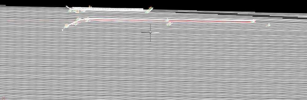

Running ACAD 2018 and for some reason, I'm having some irregularities with hatching on this particular drawing. I've dumped most of the data and left two AR-B816 hatch patterns on the uploaded sample.
In the top example, if I change the rotation angle to anything between 176 and 179 degrees, the hatching disappears. Setting it at 177, then changing the scale to 0.04 will make it reappear, but then try changing the rotation to 178 (it disappears) or to 179 (it goes crazy).
In the bottom one, there is similar behavior. You can see the line extending out to the left which is outside of the hatch area, but which is UNSELECTABLE.

HI,
as seen in attached images and when i open your CAD file i found a very big hatched circle and your elements locate on the top of this weird circle.
i suggest to do the follow :
  • Audit and Purge (Reg) your CAD drawing.
  • take and move your elements near to 0,0,0 .
  • WBLOCK your elements to new CAD file.
hope now that your issue solved ... if not please attache your new CAD file for testing.
Good Luck...

Hi @NHHiker,
I suggest moving your model objects to a new file. My poor little laptop's video card couldn't handle the size of this hatch you have inserted.

Regarding the hatching: The hatched area is actually quite small. However, as you change angle/density, it can explode in size or disappear completely - ignoring set boundaries in the process. As suggested previously, I will try exporting the work as a block. But understanding what is going on would REALLY be preferred so that I can avoid this in the future. I have not created any 'weird circles' which should be interpreted as a hatch boundary. Nothing shows up via a Zoom Extents with all layers turned on. In fact, with the right combination of hatch density and angle, I can not only see the circle of bad hatching, but a second one on top - almost fractal-like in its appearance.
