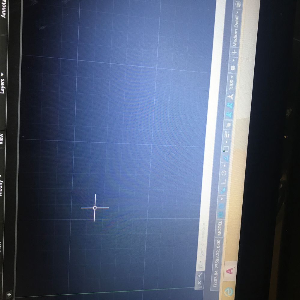

Message 3 of 9
When I click on the dynamode it says on but it doesn't shows up on the cursor

Message 6 of 9

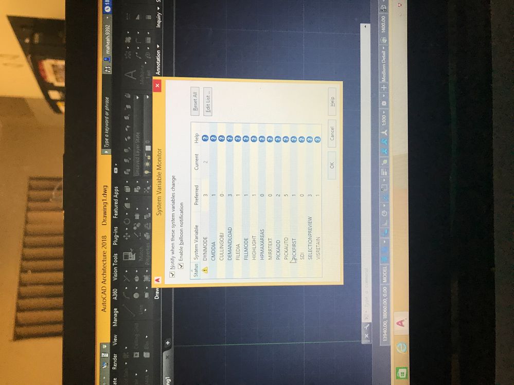

I did but still doesn't show the anything close to the cursor
Message 7 of 9
When I reset all still doesn't work
Message 8 of 9
1.pngYou should right mouse click in icon dynmode like picture then you choose setting. You check and click all. Good luck
Message 9 of 9
Alfred.NESWADBA
your setting of DYNMODE is 2, try 3.
