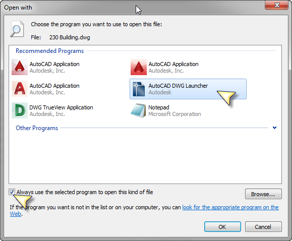

Ed__Jobe
See the attached images. After you do these steps, then Open 2018 as directed and it will be the last used profile. If you don't see Dwg Launcher as an option, browse to it at C:\Program Files\Common Files\Autodesk Shared\AcShellEx\AcLauncher.exe.
Ed

john.vellek
Hi @scoopthepoop2000,
I made a quick video that shows how I would suggest you select this application when associating your dwg files with it.
Let me know if this works for you.
John Vellek
Message 11 of 14
scoopthepoop2000
That worked. Thanks for everyone's help.
