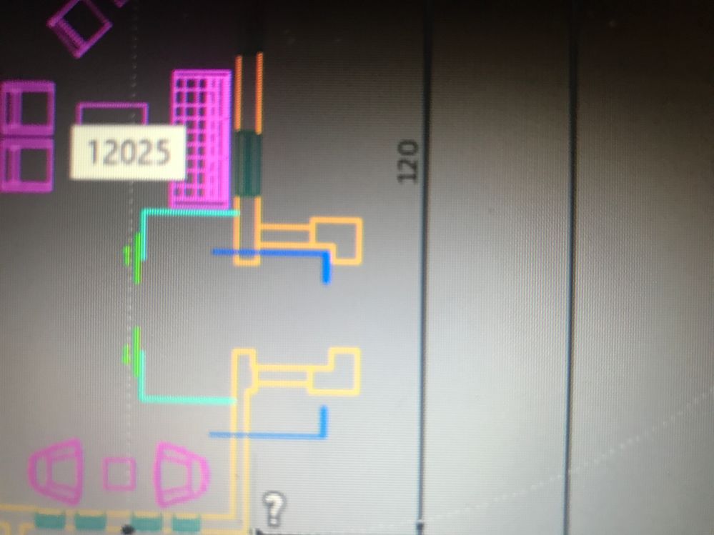

I have set all the settings up correctly for dimensioning in paper space but when I do the dimension it is showing as 120 for example. But should be 12025mm which is what it measures at. Can anyone help me? IMG_0253.JPG

In case the incorrect dimension value is shown for dimensions created with object-snap (to existing model-space objects) ... please upload the dwg file with your dimension object marked which shows the incorrect value so we can look into your settings.

I have attached the dwg file. I have drawn one dimension, however after experimenting it is all that are wrong.

edit your dimension style to be not annotative, set it to dimscale = 1 and you'll get the correct value displayed.
Making objects annotative only makes sense for model-space objects, which are then displayed in multiple viewports with different scales.

Thank you for helping, I have just changed it and unticked the annotative box and they're still appearing too small? 418 instead of 41825 or something similar.

And you have created a new dimension? (the old one already has the annotative flag)

Yes I drew a new dimension. It says in the properties annotative no as well.

have you used object snaps to create the dimension (in your first drawing you had not, the right dim-point was created in empty space).

Yes I realised that, I tried again snapping them, even on a different measurement and the same thing is still occurring.

Please upload the last drawing with the new dimension (dimension style not annotative).

Thank you, here it is with a few dimensions. All should be essentially times by 100.

I don't know what you select (which object snaps are activate when you create this dimension)
When I turn on the ANNOMONITOR I see that this dimension is not anchored to a geometry.
Using command _DIMREASSOCIATE and show 2 end-points resolves the dim-value.

Thank you so much! this has worked
