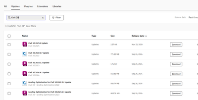

jwilliamsZRQUC
You see the problem? my smart app that lives here, says it's up to date - maybe it's cause I used Civil3D and don't use AutoCAD.  I know we used to have to have both installed but as I've understood it, for the last few years, it's a standalone program
Message 22 of 44
jwilliamsZRQUC
latest update available on AutoDesk's own website is 2024.
you can act high and mighty if you want but if CAD's user interface is jacked, someone should address it.
When things aren't working, I look for updates and if the app and website say I'm up to date then why would I look further ??
