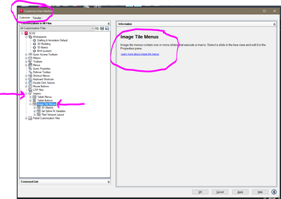

Then roll up your sleeves, you have a lot of coding and testing to do in CUI command: I'll get you started right here

You probably already know this, but in case you aren't aware, Image Tile Menus are in the "Legacy" category and as such they are likely to be deprecated at some point in the (probably not-too-distant) future.
BTW, I sympathize with you on this issue and wish that Tool Palettes were a little less clunky when it comes to sharing among a group of users.
