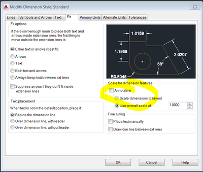

Similarly, go into your Dimstyles and turn off the Annotative feature.
Please post your results so I can assist you with this issue.
