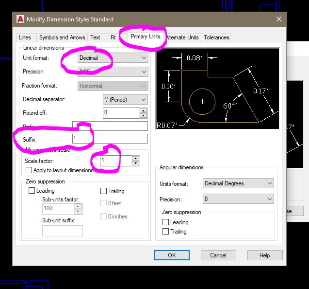

My drawing was in inches and I used -DWGUNITS to converted to feet. An object that had a dimension of 72" after the conversion to feet now shows a dimension of 6 (72"=6'). The problem is that the dimension of six is actually 6" not 6' that I want. I've done previous conversion and haven't had this issue.  Please let me know what am I doing wrong?

Your DIMSTYLE is set to multiply all results by 12:

-DWGUNITS has absolutely nothing to do with DIMSTYLE settings.
See attached and below, this is how you set it for feet: and remember, your unit is always a foot.
Message 9 of 11
Kent1Cooper
You have it set up for Architectural Units, in which a drawing unit is an inch, despite your -DWGUNITS setting [which, as I understand it, has more to do with the drawing's relationship to other drawings  than internal conditions, but it's not in my vanilla AutoCAD -- only in overlay programs].  The same is true for Engineering Units.  If you want a drawing unit to be a foot, you have to use Decimal Units.  Civil Engineers do this all the time, and they define their Dimension Styles to add a foot mark as a suffix.  The drawback is that your [for example] 2'-6" dimension will come out as 2.5'.  I'm not sure there's any way around that.

With AutoCAD, you cannot have dimensions in ARCH or ENG (inches) if your DWG file is feet. You have to decide which way is more important.
How did you dimension the line your drew? Are you forgetting your DWG file is now in feet, so 1-unit=1-foot? See attached white line next to your bench, it is 6-feet long drawn by entering only 6 when asking for length.
