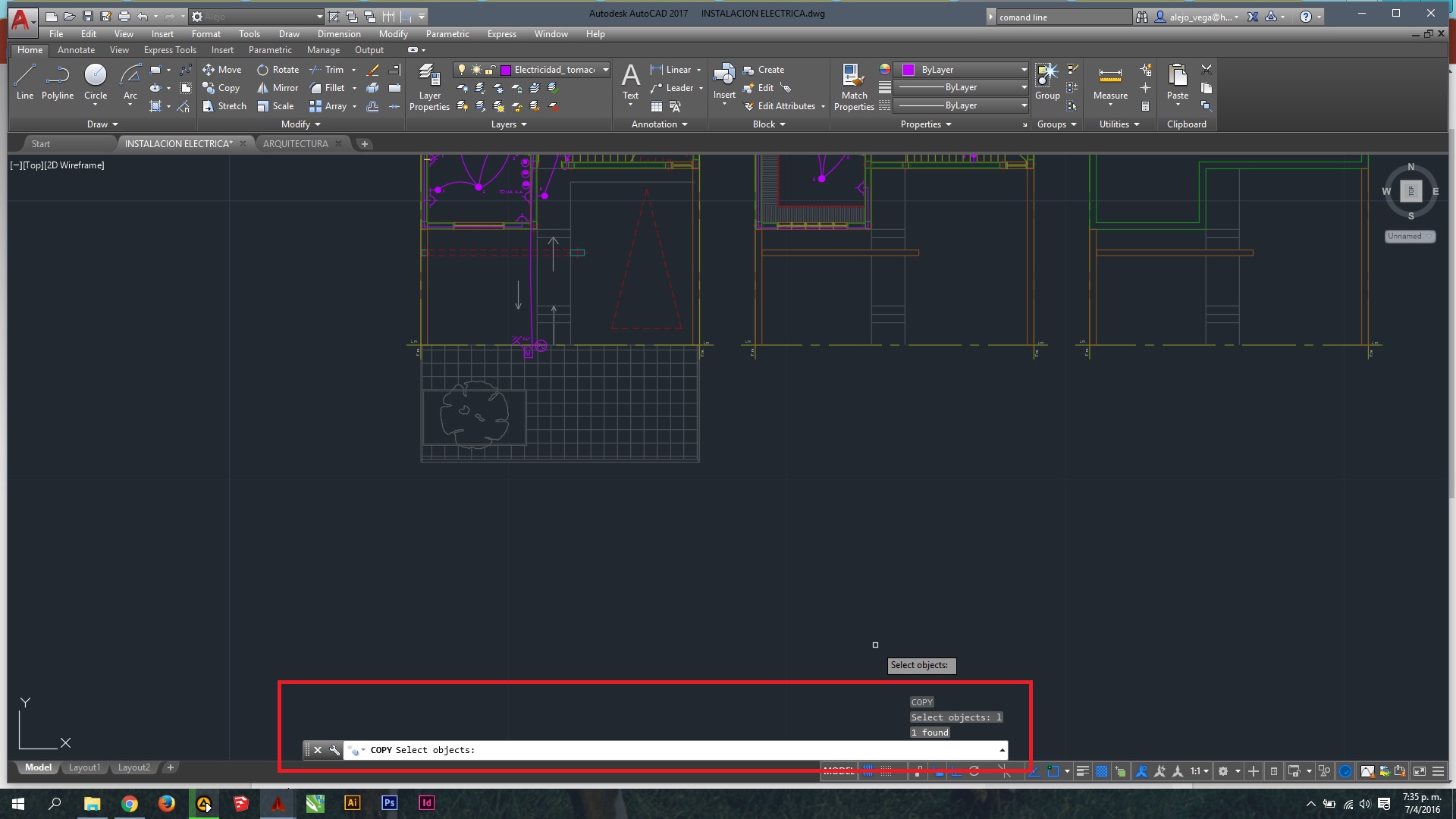

Hello i'm having a problem with the alignment of the command line text, i don't know why the text is aligned to the right... does anybody know how to align the text to the left?

Hello alejo_vega, and welcome to the Forums!
I am having a hard time reading the little screenshot you posted.
Can you please attach the screenshot to the post so we can get a better look?

Message 3 of 21
the version is 2017, i don't know how to attach the screenshot...

Message 16 of 21
I do not know if it is still actual. Anyway, in order to get rid of that strange alignment, just slightly increase the size of the command line in vertical direction, so it will able to contain at least 2 rows and the problem will gone. I struggled with the same problem. See pics below.
