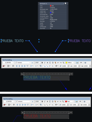

Hi everyone! I want to change the color of multiple multileaders. In the first picture, both multileaders are RED. but inside the text formatting, one is Yellow and the other is Red. So i have to double click on each multileader to edit the color, and that's very tedious.
I already try the lisp routine StripMtext v5-0b, but it doesn't work cause only change the color inside the text formatting, so doesn't let me change the color in the quick properties.
So, what i want: all the multileaders with color BY LAYER not a true color individual.

Yes, i tried, but doesn't work for me. Like i said, i tried Stripmtext but the result is the text on the color OF the layer (any color) but i can't set as BYLAYER. So I'm at the same point, cannot change the color on the properties pallete (like second image)

You are right, the StriptMText up to v5.0d will fix just one of the both possible color-issue.
I will publish a striped version of my version StripMtext v5.0f for you <click!>

That works perfectly, thank you so much! I wish i knew so much as you do.
