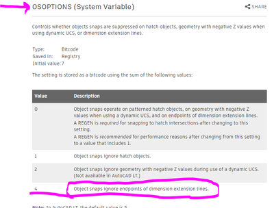

Message 4 of 25
cadffm
>>" i checked ignore dimension lines"
There is no option for this, just for:
"Object snaps ignore endpoints of dimension extension lines."
Only ENDpoints, and ONLY dimension lines,
no midpoint or per filter, no arrows or extension lines filters.
You have to work well with the mouse to control the snap-points, no extra trick
Sebastian

Message 13 of 25
cadffm
@simonquinn wrote:
there are 2 places i go to for these options.  one is the drafting tab in options where i check mark ignore dimension extension
Right,
OSOPTIONS
For this, read my post above.
@simonquinn wrote:
and the other is filter options in the snap settings the am preferences.  so i am all out of ideas.
As i wrote: There are no "ignore" setting, not in AutoCAD.
Sebastian

Message 17 of 25
pendean
Community Legend
Community Legend
@simonquinn It is easy to assume what we all wish, but if you look it up in HELP, it explains the limitations
And that's MIDPOINT, not ENDPOINT, and at the arrow, not the extension
You'll need to FREEZE the layer the dims are on or temporarily hide them using this right-click menu option
HTH
