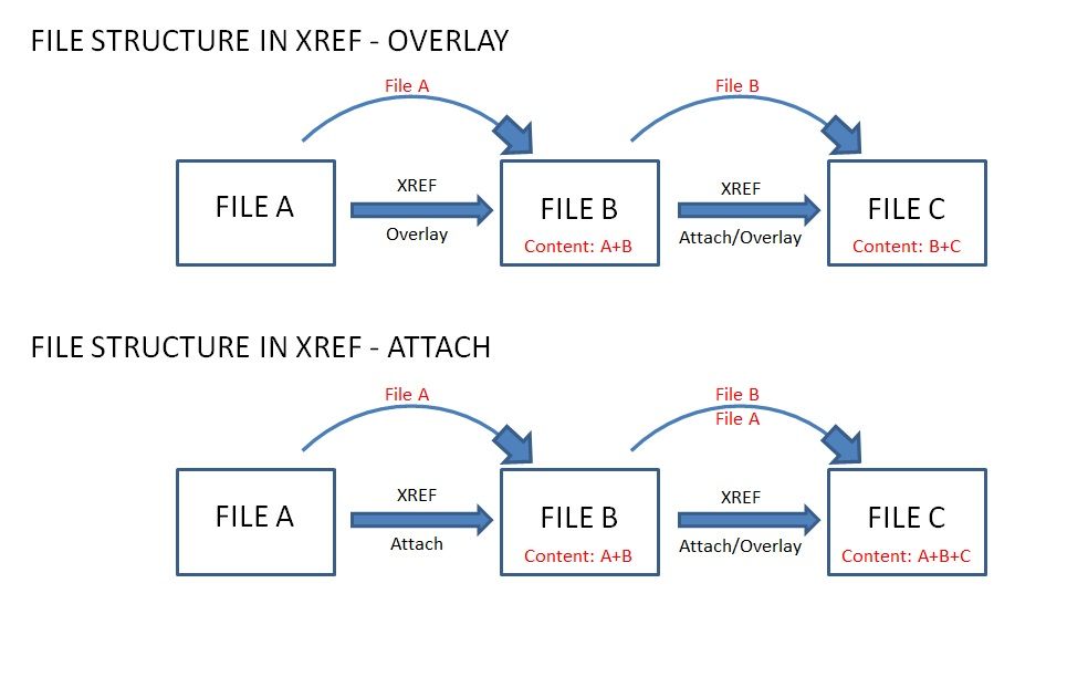

I can't change the saved path of an Xref.  I know this has something to do with the old Xref being "nested".

In the case of nested xrefs, you'll need to open the direct parent drawing of the xref in question. If you're trying to edit the path of "C", open "B".
XREF%20ATTACH%20VS.%20OVERLAY
