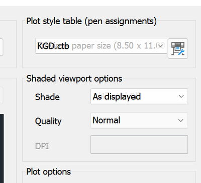

Hi all,
I have a problem with Windows 11 (with the final build before debut). When I use the toolbars with list option, they will have a burn-in text in the list cell (like burn-in phenomena in cell phones). This happen all the times when using Autocad. The only way I have to make it temporary disappear is REGEN all. I think this is an incompatibility of Autocad on Windows 11.
Note that i test it with both Autocad 2021.1.1 and 2022.1. Do you have any solutions with this prolem?3.jpg

I have same issue with AutoCAD 2020 and final Windows 11 version, only way I find to fix it is turn on high-contrast theme for windows. Looks like it is kind of OS incompatibility.

Graphics card/memory issue.
In AutoCAD 2021 LT on Win11 had about 1/3 of the lower segment with a blue line on a 4k monitor and the same line on a 2k but only on only about 1/8 of the screen that would not display most of the layers around it, so it had to be graphics related since it wasn't present on a 1080p.
In my case the solution was to:
-lower graphics performance from Advanced Mode to Intermediate Mode. (lower right toolbar in AutoCAD)
-wasn't necessary but I also turned off "Game Mode" in Win11
Basically Win11 is a bit more graphics card/memory intensive (since it caches more stuff to make navigation/search faster). I'm running a 2k, and a 4k, from a Lenovo Yoga C940 so less than 12GB of shared memory between system and graphics, worth a try...

Clinton
I discovered I had the same problem since upgrading to Win 11 a little while back. I have a Dell laptop with NVIDIA GeForce discrete graphics card.I discovered that Windows now controls the graphic card selection, not the NVIDIA Control Panel. Adding AutoCAD (I have LT 2022) to the graphics app selection, and telling it to always use the NVIDIA graphics card & not the integrated graphics seems to have solved the issue (though I did also turn off game mode). I didn't need to change the graphics settings down from advanced within AutoCAD.

DougmanXL
 The only thing that helped with this, was disabling most of the "performance options - visual effects", but doesn't completely fix it.  I'm getting the issue mostly in drop-down menus.  I think it has to do with fading list boxes.

jacks1731
got a new computer and it came with windows 11. supposedly AutoCAD 2021 and 22 are now compatible with windows 11 but this burn-in phenomenon is happening to me with almost all menu text. if i hover over it or click in it, it usually fixes itself or changes but it is pretty annoying. has a fix been found yet?
