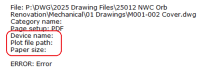

Just upgraded from Acad 2022 to Acad 2025. For some reason the batch plot utility does not plot anything. here is the error I see under publish details:

perhaps with the upgrade installation the custom plot devices were not migrated over...I see these missing:
Have you tried manually plotting that file to see if it works?

yes, they plot fine individually. I'm using the 'publish to plotter named in page setup' setting as i always have. I'm using Bluebeam to plot individually and that setup in my files has always worked flawlessly. I've made new autocad files and setup new BB plotter setups to make sure it wasn't something saved into a 2022 .dwg, but that's not helped either.

Do a screenshot of each of the Plot window and then the Publish window. I would like to see if the page setup name “PDF” matches with what’s shown in your OP screenshot

That may have done it. All my drawings plot with the bluebeam PDF printer/plotter, but when I select the saved PDF page setup from my pull down list, it switched to "none". Renaming my page setup appears to have fixed the issue. Cautiously optimistic.
