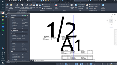

I've been working with attributes inside of blocks. After inserting the block and filling in the attributes, the text appears very large.  I haven't found a way to get the text to scale to the right size. I even tried ATTSYNC.

builder7772001
This is after inserting the block with the attributes.
This is after selecting the block and choosing to edit the attribute under text options - the height is grayed out.
The text is one that I set up
This is the text style that I set up for the title block. The paper text height was set at 3/32"

Try remove "Annotative" from the text style.

Your Text Style named MyText has a Paper Text Height of 0'-0 3-3/32". Change this value to 0.00.
