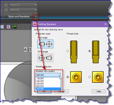

Victoria.Studley
Hi @Anonymous,
Thank you for posting. As @Alfred.NESWADBA suggested, you may need to increase the resolution of the views to achieve a smoother shaded fill.
To add to this, you need to adjust this setting before generating the view - it cannot be set after the fact.
Victoria Studley

Message 13 of 13
Thanks for the suggestion, but the DPI setting is already at the maximum 300.
I will speak with my manager about uploading a new DWG, chances are he'll probably want to do it himself though to make sure all the binded Xrefs have the cost attributes stripped - so I may have to wait for him to do that.
