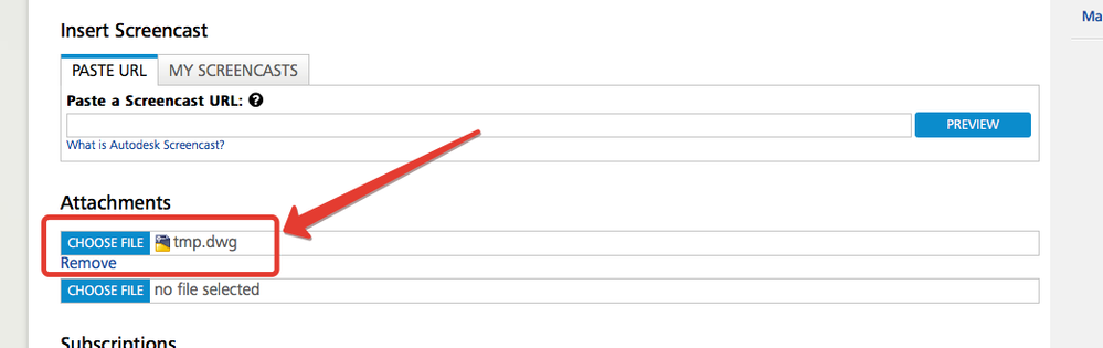

After you choose file to attach, ensure it is in attachments:

Hi Clive,
If you want to attach drawing, then you should use browser for reply.
