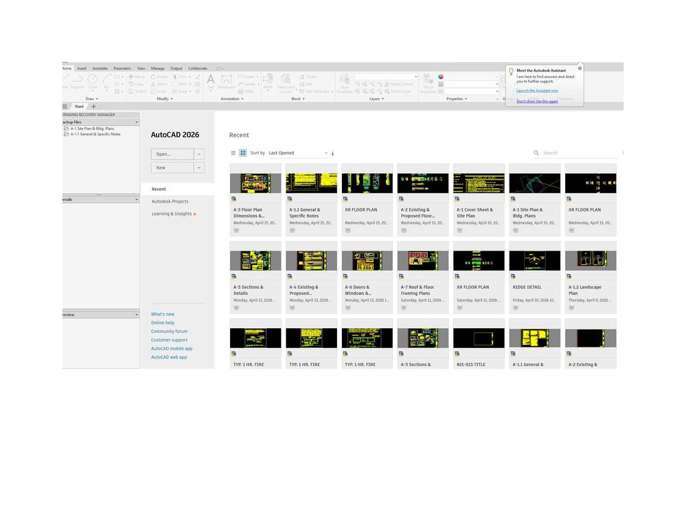

Once I launch AutoCad and get this screen it locks up and I have to do a task manager end task for AutoCad. This only started yesterday and I caN do nothing with AutoCad. I am basically unable to get anything done.autocad locking up once launched.jpg

I suggest following solutions in this link AutoCAD freezes or hangs right after startup

I'm having the same problem.  It appears it might be linked to the latest security update from windows
Security update (KB5083769)(26200.8246) INSTALLED 16/04/2026 –
OS Builds 26200.8246 and 26100.8246, cumulative for 25H2 and 24H2
but I'm not savy enough to fix it ☹️.  Really need help

avishek.chakrabortyCSXPN
Hello @paulhenricarvalho
Thanks for sharing this issue on the forum. From your description, it seems AutoCAD 2026 is freezing immediately after launch, and you are unable to proceed unless you end the process through Task Manager.
In some cases, this behavior can be related to a recent Windows update. Please check whether the Windows update KB5083769 is installed on your system. If it is, refer to: https://www.autodesk.com/support/technical/article/caas/sfdcarticles/sfdcarticles/AutoCAD-products-f...)
If the issue still continues, please share the following details so the community can help further:
• Your exact Windows version and build
• Whether this happens with AutoCAD 2026 only or with other Autodesk products as well
• Whether the issue occurs in all user profiles on the machine
Please let us know the results after trying the above steps.

Unbelievable, half a days works lost sorting this one out! Remove the Windows update KB5083769 and all working ok again.

rokitlady2023
Tony,
I just uninstalled KB5083769 Security Update and my AutoCAD is working again.  It's awesome!
I've been unable to open AutoCAD for 10 days!
Susan
Message 16 of 21
rokitlady2023
The instructions below [1 - 4] should help the authors of Messages #10, #11, #12 and #14.
I have been able to Uninstall the Windows Security Update KB5083769.  Now my AutoCAD is running smoothly again!  I have been unable to use AutoCAD for about 10 days and that problem cost me my peace of mind.  I'm running Windows 11.  Here are the steps FURNISHED BY MICROSOFT ON HOW TO UNINSTALL A WINDOWS UPDATE:
1. Select Start > Settings > Windows Undate
2. Under More Options, select Update History
**then View Update history**
3. Under Related settings, select Uninstall updates.
4. From the list, select update you want to remove, and then select Uninstall
(The Update KB5083769 was removed, and life with AutoCAD is good again)
