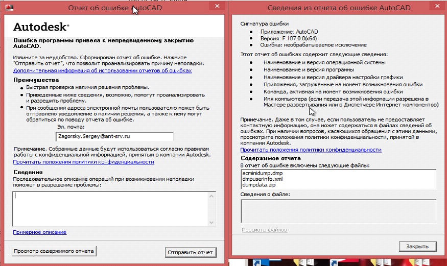

AutoCad Hangs when accessing the Tool Ribbon. If you reset AutoCad, then after the first start it works without errors. On the second start, errors appear again. Autocad 2012

1) All AutoCAD Crashed. Ask me to save changes in the file, after ask to send report to Autodesk, I send it.
2) Windows 8.1 pro it was clear installed two months ago(MDT+WDS image+install app, no one else сomplaining)
3) desktop, 1 monitor

When you get the crash please show a screenshot from the message box you get.

1) no one use AutoCAD in this 2 month on that PC
2) Screen in the Attachment
3) It work well now on other profil. I try to recreate user profil but error did not go away...

Don't you get a messagebox before this dialog? This screenshot shows the second window after AutoCAD crashes.

2) Where is First screen if some file was open, AutoCAD ask me to show place where I can save it, but no more Error messageboxes it shown... AutoCAD just shutdown and I see that messagebox like in last attachment...

The problem is resolved. There were two mistakes. 1) it was decided to recreate the profiles 2) disabled the InfoCenter service through the registry. Internet access is limited and AUTOCAD hung on her calls Thank you to everyone who responded!
For disable InfoCenter
(vl-load-com)
(vl-registry-write (strcat "HKEY_CURRENT_USER \\" (vlax-product-key) "\\ InfoCenter") "InfoCenterOn" 0)
