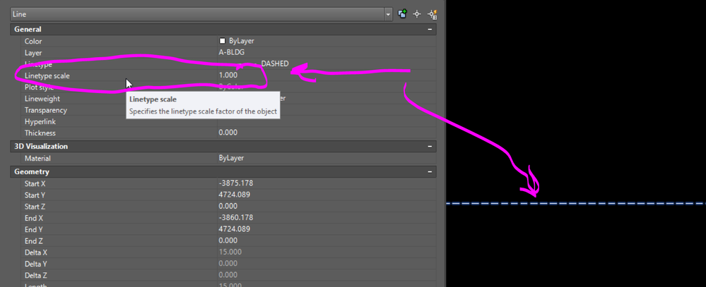

SeeMSixty7
Your default entity ltscale is set to 0.001 it is not going to show up well at all.
The drawing you sent had it set that way.
CELTSCALE should be 1.0
This will not fix entities already drawn that way. You will need to highlight them and change their ltscale to 1.0

Message 26 of 41
vinodkl
set the linetype scale of line to 10 in properties and then Set MSLTSCALE to "1" and then use regen.

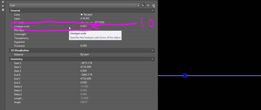

SeeMSixty7
I opened your file, applied the correct LTScale to the entity in the drawing, set your CELTSCALE to 1.0 and it works fine. I have attached your original file fixed.

Alfred.NESWADBA
try to start command _GRAPHICSCONFIG, turn off the hardware acceleration, not change the properties linetype scale factor to 1.0 (from 0.001 in your drawing) and at least run command _REGEN.
If that also does not help and as you have mentioned you have other issues too then please reset the AutoCAD profile to default as shown >>>here<<<.
