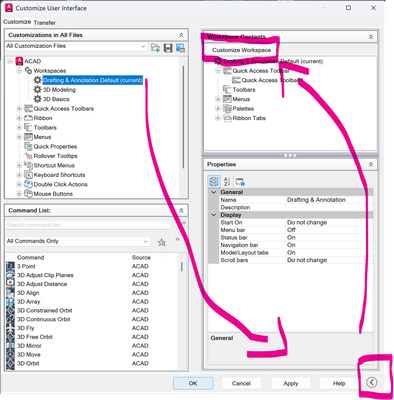

earlier in the year, using a Youtube video, I set up my AutoCad Architecture 2025 with different tabs, etc. I had 3 different "Home" tabs. One as the standard AutoCAD options... a second with the AutoCad Architecture options, Windows, doors, walls, etc...
I had to uninstall a few programs and reinstall them again, AutoCAD being one of them... but now I can't find the video of how I turned on all the different Tabs.
I have attached an image... and as you can see there's only one "Home" tab in the drop down menu... but before the was 3... and also many many more to chose from. How do I get access again to them?

Right clic the arrow drop down in the Quick acces tool barre and and chose Customise...tool barre.
In the now appeard CUI editor, go in the top tab Customise in all drawingthen Ribbon and then Tabs
There you'll be able to customise selected tabs by right cliccing and add/delete subtabs.

Basicaly we are at the right place. This CUI pannel is were everything happen. And more precisly i think you have a Workspace issue.
You possibly changed your workspace by accident, and that's why the home tabs disapired. We'll just change from Workspaces
Or  we will have to customise a Workspace throught the CUI pannel and add the desired Home tabs
Send my a screenshot of your entire autocad window so that I can better help you.
In the mean time, this youtube video could help you deal with Workspaces and tabs management and customisation ;  https://www.youtube.com/watch?v=YarGZLdOSvw

Yeah there one and only Workspace. So 1 can't be the issue. If this current Worksapce doesn't propose what you search for, means you lost your previous workspace setups by reinstalling Autocad. We'll have to go with solution 2 to recreat them
Let's go with solution 2 and creat a customized new Workspace with the desired tabs.
To do so;
From the CUI pannel, right clic the existing Workspace and creat a new one. Selecte this newly created workspace. On the bottom right corner clic the arrow, then, on the top on the newly appear part of the pannel, clic the ''customize'' button.
From there, on the left side on the CUI pannel, check the desired tabs. Apply modification. Press ok
Back in your Autocad Workspace window, selecte the new Workspace. If not displayed, You should be able to make appear selected tabs on your ribbon by doing thr same inputs shown on your first screenshot

@mccauleyeamonnE8QMU In AUTOCAD-ARCHITECTURE you have to pre-load the plain AutoCAD CUIx file first in order to add it's HOME tab to your ARCH2025 workspace.

I'm not aware of differences between full Autocad and Autocad-Architecture. CUi cutosmization shoulf work the same. But seems to be differences in the checkable tabs
If I summerize it right, a .cuix is basicaly a presetted CUI customizisation. Instead of doing it mannually on your own throught CUI pannel, you import this  .cuix and it appears. Basically someone makes for you the customized .cuix and you just import.
My explaination were in order to do it on your own. But if the .cuix way suits you best. Go for it. Make sur to import the right one. And back up yourself and know how to undo the import. Could be handy
Note; This screenshot of my last reply refers many Home and Insert tabs. Are those the one you look for ? Can make the .cuix on the spot @mccauleyeamonnE8QMU

Yes those are the Tabs (Droids) I'm looking for. My problem is they are only available in the AutoCAD workspaces... and not the AutoCAD architecture workspace. (I can't seem to find them within the AutoCAD architecture workspace).
I was thinking though... If I change my AutoCAD Architecture active profile to the standard AutoCAD active profile... then I can see and select all the Home Tabs for making the .cuix file? I can then save that AutoCAD profile .cuix file and import it back to my AutoCAD Architecture active profile?? Does that make sense?
