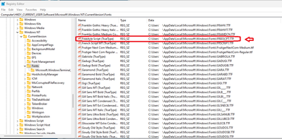

In my machine, the TrueType fonts are in "C:\Users\<username>\AppData\Local\Microsoft\Windows\Fonts\".
Could you check them in your Registry Editor. The path is "Computer\HKEY_CURRENT_USER\Software\Microsoft\Windows NT\CurrentVersion\Fonts"
Following image shows the information of "Freestyle Script" font in my machine:
Could you share a similar screenshot with us?
Message 13 of 17
dmiller_SCE
@james.jinan.xue, yes, multiple installed fonts do not show properly. I have verified that the fonts are installed properly, and again, other versions of CAD do not have this issue.  Also, please note that I have created a support case with Autodesk but haven't received a reply yet—support case ID 22151795.
