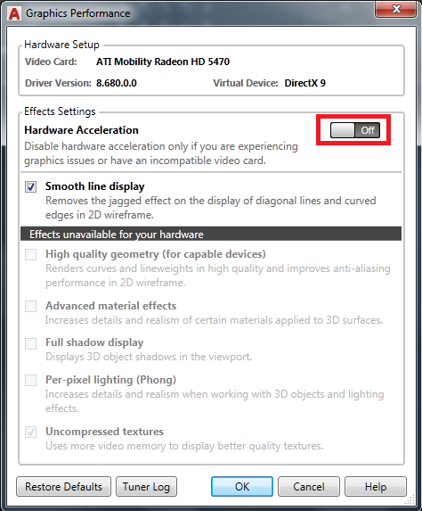

@oswaldodcbone more problem though, everything is laggy and jaggy when creating lines. But when I turned on the graphics accelerator, it goes smoothly. What do you think I need to do to lessen or remove the jaggy lines?
Message 10 of 15
neaton
It appears you need Hardware Acceleration on for your work. That means you should probably look into upgrading your graphics card to one that is <<supported>> by ACAD 2018.
You can turn on only the Smooth Line Display in the Graphics Performance dialog box but it may not solve your problem.

Turning off hardware acceleration is more of a diagnostic procedure than a final solution; if the problem goes away that's an indication the problem is with the graphics system.  Rather than replacing hardware right away, look into updating the driver for the hardware (ensure you can go back to the current version before doing anything, just in case).  An updated driver version can solve many graphics problems without having to crack the case.
