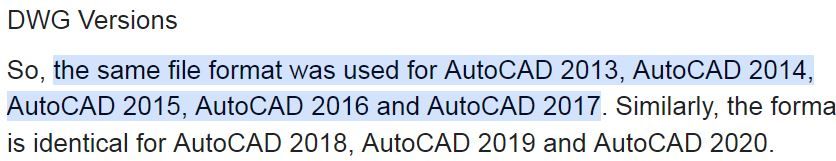

Patchy
The problem is your Autocad 2016 is not compatible with Win11, not because version 14 of the dwg.
All the same as shown here:
