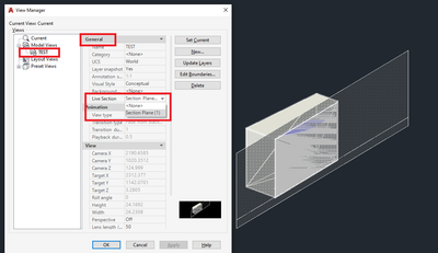

imadHabash
You can get it as shown in below image...

varg.zaugg
Please read my post.
No, I can't get it selected. This is why my post exists here and shows at the second screenshot, that it doesn't work.
Has anyone an idea why it doesn't work?

Message 6 of 12
imadHabash
If you get back to the link in your Original Post, you will find that all of your need exists in the first dialog (view manager).
Imad Habash
Message 7 of 12
varg.zaugg
The order to create/save a view first may be crucial, sure. But it doesn't work.

R_Tweed
In this example, I'm using ACA in paperspace. Click within a paperspace viewport and type view command. The view dialog box will appear and all options are available.
Message 12 of 12
varg.zaugg
I found out the error source: It works in AutoCAD Architecture "as AutoCAD".  But NOT in Autocad Architecture.
But why not in Autocad Architecture? Probably prorifle or dwt-setting?
I still assume a system variable value......
