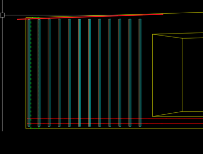

Hello!
Is it possible to array an element, but to increase the lenght of this with a constant value from element to element?
As you can see in the attached image, I want the rebars to follow the gradient of the beam (the red line) without straching manually every single bar.
452 Views
ВeekeeCZ
No picture posted. Also post a dwg sample.
bbianca_ioana
Sorry, now i uploaded the picture and a dwg sample too
ВeekeeCZ
Perhaps look at THIS solution.
bbianca_ioana
It worked. Thank you
