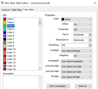

Also, check the following and use the default Monochrome.ctb (attached).
As last resort, reset AutoCAD to defaults.

In any case, I changed the plot settings as you suggested and still have the issue when I view it with Bluebeam. But again the issue is gone when I view it in Chrome.
I think this is an issue Bluebeam not playing well with AutoCAD PDF pc3. I will bring up the issue with their support team.
