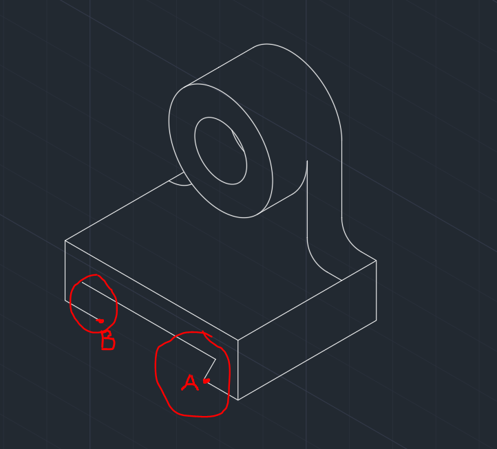

Hello, I am new in AutoCAD. I am trying to make a angle in isometric view. I have a 2D front view and trying to make its isometric view. The front view is added here (File name: Angle.png). I have tried it several time to make the proper angle. But, it is vain.
Can anyone please tell me how can I create this angle?

Locate the endpoints and connect those with a line

Sir, Thank you for your reply. But how can I find those end points? 😞
Message 4 of 13
leeminardi
A 60° line has a horizontal displacement of 1 and a vertical displacement of sqrt(3) = 1.732...
Therefore, from point A go 1 unit in a direction of -30° and then vertically up 1.732. Connect these two points to get the isometric projection of a line at 60°.  For point B go 1 in the 150° direction (up and to the left) and then 1.732 vertically up.
When drawing lines that are not parallel to a principal axis you will need to determine the angle by using the horizontal and vertical components of its slope and not the angleimage.png

Sir, I am doing this. 😞
Message 6 of 13
leeminardi
And what you are doing is wrong!  YOu are creating a line at 60° up and to the right which is not the angle for an isometric view.  The second line you create is at 30° up and to the left.  Again wrong.  It doesn't sound like you took the suggestion I presented in my last post.  You cannot use true angles in an isometric.
Try the following, create an isometric drawing of a perfect cube and draw lines between opposite corners as shown below.  The red and green lines are at an angle of 45° on THE REAL OBJECT but are not at 45° in the projection.  The red and green lines are the same length on the real object but not in the isometric drawing.

SEANT61
Another way to process the isometric angles is via construction geometry.  I arbitrarily chose some dimensions not provided, but the general idea is still valid.

Sir, I have done this!
And you did well.  Those are the angles that should result.

@SEANT61  sir, I want to show 60 degree in isometric view!
No, you don't.  An angle of 60 degrees in an orthographic projection will not be 60 degrees in an isometric projection.
I'd prefer to use the solution shown by @SEANT61 in post No. 7 and would suggest you to do so too. This is an exact construction. You use a rounded numerical value. Maybe this lack of precision is akzeptable for you at the moment, but this inaccuracy can cause problems in the future.
