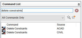

Found it...
You need to use the full name instead of the abbreviated name...

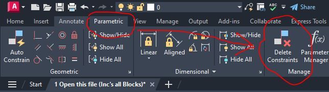

If you KNOW where it is in Ribbon, then follow the path and locate the command. When you do, click on the command's icon...
BTW keyword "constr"... will find it.
