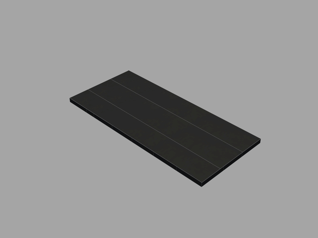

Is there a way I can hide the frame of an attached raster image when I render it?
I have already set IMAGEFRAME value to 0, but that seems to work only for regular views and plotting, not for rendered views. I want to save a rendered view of my project as a picture, and nothing seems to work. The frames are visible, and strangely their color (white) is different than the one I've chosen for the images (red).
Can anyone help?
(the attached file shows the frames/lines I'm talking about, if you look at the kitchen countertop)

I tried to render with IMAGEFRAME=2 and got output without frames on my side.

I checkrd this once again with the file you privided and now can confirm the issue with light border around each of the images in render output.
I also checked your file in AutoCAD 2016 for PC and the "border" doesn't appear when I render in it.
At the same time rendering in AutoCAD 2014 for PC gives me the same result as in AutoCAD 2016 for Mac.
(see attached images)
As an explanation I can say that AutoCAD 2014 for PC and AutoCAD 2016 for Mac use the same rendering engine, but AutoCAD 2016 (and later) for PC uses another rendering engine. Cloud based Autodesk rendering service also uses new rendering engine.
You can try to render your drawings "in Cloud"in AutoCAD 2016 for Mac and look at the results.

I can clearly see the white frame around the images which forms the box. They are white lines around the perimeter of the rectangles.
I think that is what OP call image frames.

I have been pasting them onto white backgrounds so perhaps that is why I don't see them. I certainly don't see them in a Preview. When I do an ImageAttach into Modelspace I do see the white frame on my default Grey background. When I set ImageFrame = 0 then they are gone.
When I insert the image into a Word document with a blue background I do not see the frame.

I tried the "in Cloud" rendering and there were no borders! But the image doesn't look very similar to the one I see in my drawing. What adjustments did you make and yours looks so good on your attachment? Mine is more of a gray blur (see the attachment) than a material-like countertop. Smiley Tongue
I will accept your option -concerning the "in Cloud"- as a solution, since it worked for me, although I am a little dissapointed from Autodesk features. That is not the way I want to render my views, but that has nothing to do with you. Thanks!
